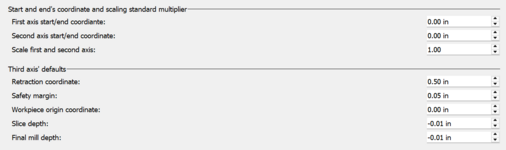

I also use inches--there is no shame in pure decimal inches!--because many components and tooling here in the USA are inch-based. I would very much appreciate the setup dialog having the option of setting the decimal places as the gcode output does (inch gcode is 4 decimal places, and for example my .0150" drag-knife cut depth shows as .01". Also the .0050" drag depth also shows up as .01". Thanks much again!

The issue with the digits is for @chrisko
