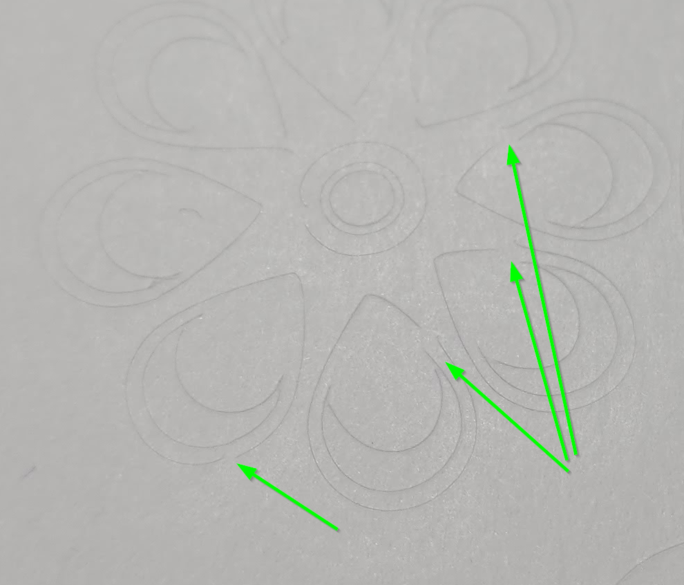

Hi, I wanted to thank developers for such an amazing tool, and ask for help.
I'm having issues with how the resulting cuts are made. I'm having uncut gaps in lines.

I was going through some testing with it, and this is what I come up with.
Seems like the gaps in lines are related to where cut path starts/ends. Meaning it is not optimized for corners/peaks.

So in the end, if I go and manually select the shapes and hit "Set nearest Start Point", the tool path becomes optimized in the way that allows for 100% cut lines.

It took me about a long while to figure out the workaround. I even played with blade offset and such :) Spent a lot of time playing with TSP parameters, until realized that it just looks for shortest. Obviously.
Do you think it is possible to prioritize the peaks (not shortest possible path through the line) when optimizing in drag knife mode, with or maybe without TSP?
On the first screeshot, when file just opened, some of the paths do start and end in a peak. Sorry I don't know what would be the proper name for this area of the path.
